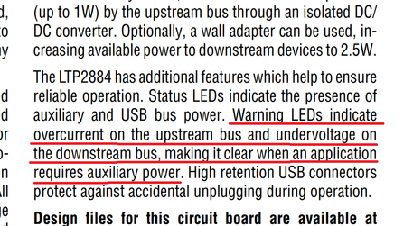

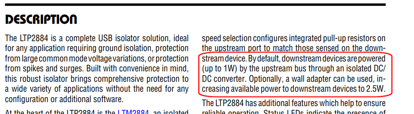

@mƎALLEm wrote:
Is this what you are using?: https://www.analog.com/media/en/technical-documentation/user-guides/dc2092a_ltp2884fa.pdf
@DhirajThakur If so, pay attention to:
Are you sure that you have sufficient power for your Target?

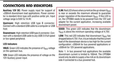

mƎALLEm
+ If so,
Check ILIM LED.
Did you connect an auxiliary power supply (12V) to increase the power?
