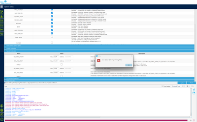

Hello Jocelyn,
I did now tried to set the secure protection bits, which does not work via CubeProgrammer v2.15 and v2.10.
_________________________________________________________________________
CubeProgrammer v2.15:
- SECURITY bit is set
- SEC_AREA_START1 to 0x000
- SEC_AREA_START1 to 0xfff (same values to protect whole bank tested as well)
-DMES1 checked
-> no popup window
-> progress indicator does not stop (even after minutes)
-> output log on verbosity lvl 3 shows nothing
-> read the option bytes stops the indicator and reads the default setting
CubeProgrammer v2.10:
-DMES1 checked
-> popup windows with warnings that we can do serious damage
-> Error: Option Byte Programming failed
-> see attached screenshot with log (Secure Protection level settings were set and now reset with the error pop up)

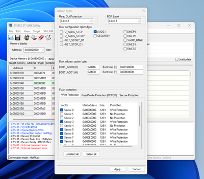

st-link utility tool v4.6.0.0
-> "Internal command error" while opening the option bytes menu
-> It seems to read the correct values (security byte is set), but I did not tried to write the option bytes because of the internal error

2024-02-15 11:23 PM
Finally it worked after serveral retries with CubeProrgammer v2.10. Thanks for your help!
