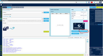

2024-02-06 8:13 AM
Hello Marcelo,
Here is how you get the license from the chip.
You connect with STM32CubeProgrammer and select the shield on the left icons. Then SFI tab, on the right side of the panel you get this Get License from HSM button.
To get this you must be connected to your STM32U5 target
This will open a dialog windows asking for license file name.
That's it.
