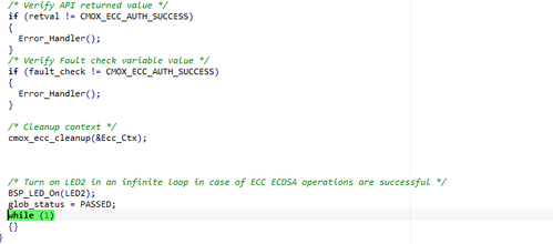

I have the same problem as everyone else, the projects I use are: STM32CubeExpansion_Crypto_V4.1.0 with "NUCLEO-G071RB\Applications\ECC\ECDSA_SignVerify".
I used the openssl to generated the ecc256 key pairs and signing the binary data to generated a signature file.
After ecc verifying, I got the CMOX_ECC_AUTH_FAIL error message and fault_check=0x0006C726 result.
Do you have an update on this issue or other professional advice? Many thanks.
