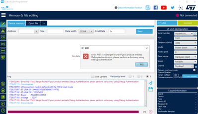

my target board is NUCLEO-C031C6. and I change the read protection level of flash from 0 to 1(0xAA to 0xBB) by STM32CubeProgrammer.
after that, the target board can not be connect any more.(keil c/ cubeMX/ cubeProgrammer/ ST-Link Utility...)
the error message is as below:
I have read related issues on forums and tried some methods from forum, ...like change [reset mode], [mode], or hold reset button and release followed by click [connect]...!
however that doesn't seem to be helpful for my situation.
any other advice will be very appreciate,
thanks~

2023-10-12 3:09 AM
hello Simon:
I have try (hot plug/ normal/ under reset/ power down) mode, it still not work,...the target can not be detected and show message as below:
the only different is when I click [Connect] on power down mode, the error message appears 1 sec slower than other modes.
thanks so much ~
