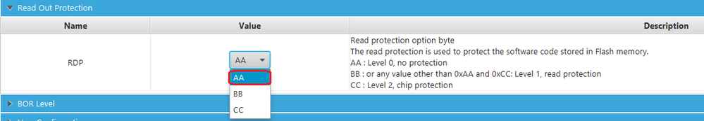

If RDP is set to 0xFF or 0xBB or any value other than 0xAA (Level 0: no protection) and 0xCC (Level 2: Chip protection), it means that the MCU is read protected (Level 1). So it won't be possible to program the MCU.
You need to change the RDP level from 1 to 0, to do so you just need to select 0xAA and then click on Apply button to save the changes.

With few MCUs my observation of the RDP value was:
- when exactly FF or simply 0, causing unexpected issues,
or expected?! => to have MCU lock in Level 1 or 2.
(FF and 0 values are not listed in the RDP Combo-box, odd behavior or bug?)

You are right the values FF and 0 are not listed in RDP combo box, this is actually a normal behavior and as mentioned in the description of RDP, any value other than 0xAA and 0xC, the MCU is read protected. So FF and 0 means that the MCU is at level 1 and OB programming doesn't impact RDP.
As I mentioned in my previous comment you need to change the RDP to AA to unlock the device.
