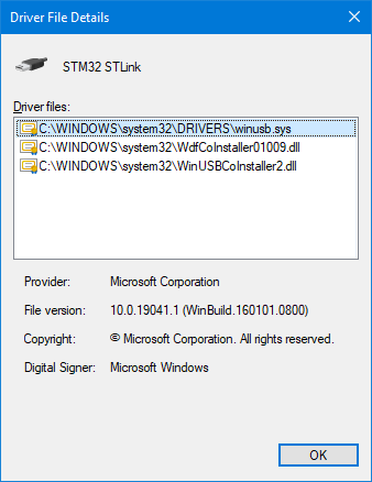

2021-06-17 7:39 AM

Any further thoughts on this? What is perplexing to me is that I can program my device through the ST-Link utility, but I'd really like to be able to debug through Cube.
