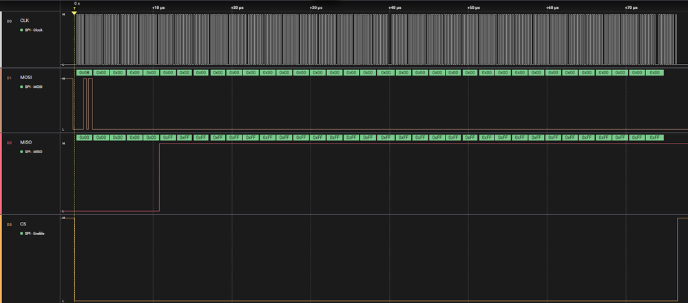

Just to clarify, when I tried to read 32 bytes, I can see the frame on the XSPI peripheral... Here is a screenshot of the logic analyzer. When I tried to read more than 32 bytes, I cannot even see the frame on the MCU pins.

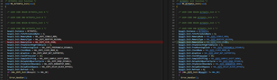

After spending some time reviewing the OCTOSPI peripheral configuration, I realized that the memory size was configured incorrectly.
After changing it, it seems I can send any number of bytes through the DMA peripheral.
Thank you. I hope this will at least be useful for other people.
