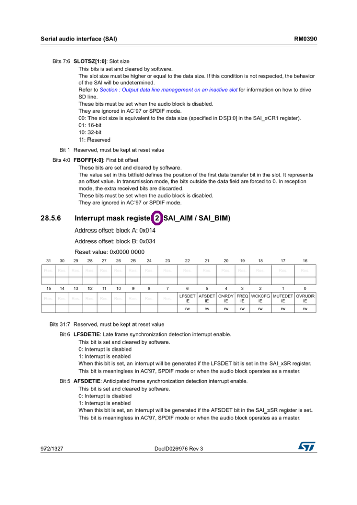

Is it a typo or is there some Interrupt mask register 1?

,We confirm this is a typo and will be corrected in coming release.

I closed this post as this error was fixed in Revision 5 of RM0390.
