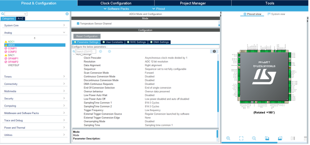

Trying to read STMU575 Internal Temperature Sensor, we get wrong readout.
We need you advise on what is required to get correct temperature readouts from the STM32U575 temperature sensor.
A. We use ADC4 configured as follows:

KDJEM.1
Hello @RLanz.2 ,
The ADC4 can measure the temperature sensor output voltage. But calibration is only done by ADC1.
So, as ADC1 is 14 bit, you can use TS_CAL value to scale to 12 bit.
This is an example:
TS_CAL1 = 0x0EB5 => 3765 = 3.0 * (3765/16384) = 0.689392 V
TS_CAL2 = 0x137E => 4990 = 3.0 * (4990/16384) = 0.913696 V
So you can use this voltage as calibration value for the 12 bit.
Or you can just change the 14bit ADC conversion result to the 12bit ADC equivalent result just moving 2 bits
0x0EB5 = 0b0000 1110 1011 0101 => two bits right shift: 0b0000 0011 1010 1101           LSB 01 is removed. => 0x03AD
0x137E = 0x0001  0011 0111 1110 => two bits right shift: 0b0000 0100 1101 1111 but rounded at 2nd LSB will result 0b0000 0100 1110 0000 => 0x4E0 (if truncated 0x4DF).
I hope this example can clarify this use case.
Thank you.
Kaouthar
