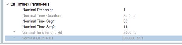

Upload your IOC file so we can see your clock and baud rate settings.

2024-05-15 2:12 PM - edited 2024-05-15 2:13 PM
IOC file attached, i.e. the one where the problem occurs.

2024-05-15 2:35 PM
It's recommended to use HSE instead of HSI for the clock.
Try these recommended settings for the CAN baud rate.
