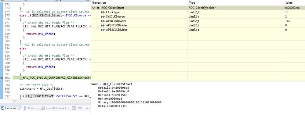

My program crashes with the following error in TrueStudio:
''Program received signal SIGTRAP, Trace/breakpoint trap.
0xfffffffe in ?? ()''The fault occurs in line 692 of stm32f3xx_hal_rcc.c:
__HAL_RCC_SYSCLK_CONFIG(RCC_ClkInitStruct->SYSCLKSource);

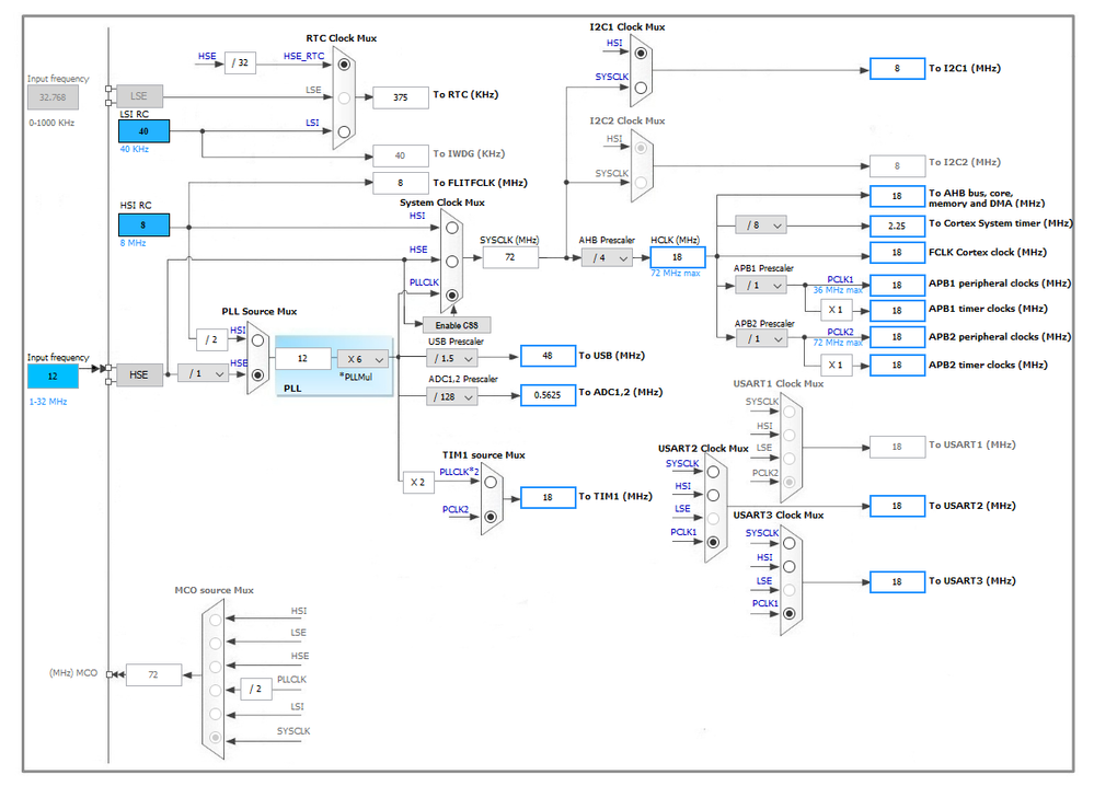

I use an external 12 MHz clock source and this configuration in CubeMX 4.25.1:

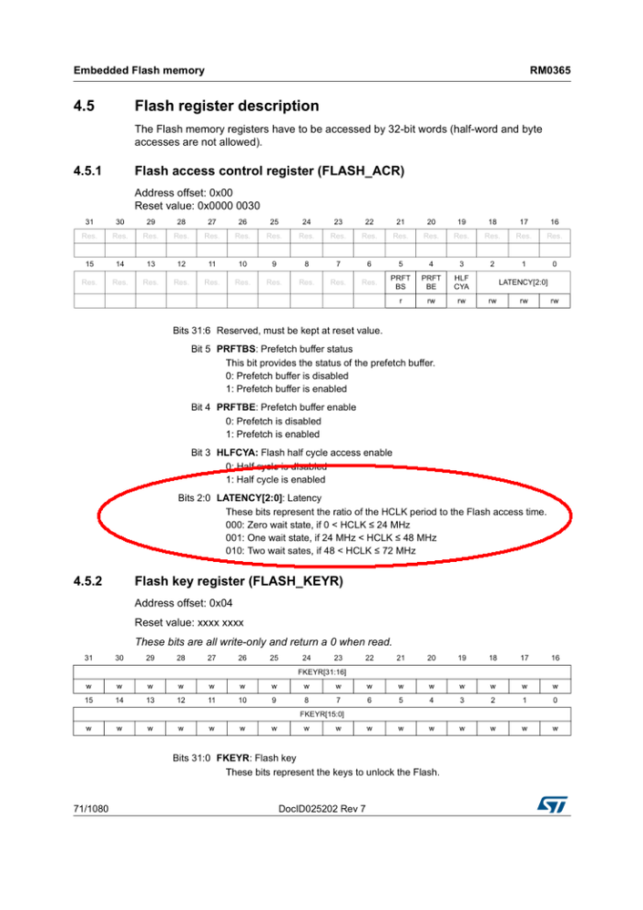

According to RM0365 the flash access time depends on HCLK not SYSCLK like in RM0008 (STM32F1...), but I tried two other configurations which indicate that flash latency should rather be set according to SYSCLK:
SYSCLK = 72 MHz, HCLK = 9 MHz -> program crashes
SYSCLK = 48 MHz, HCLK = 12 MHz -> works
Did I overlook something else or is this a bug in the reference manual / CubeMX?

Is RCC_ClkInitStruct properly initialized (i.e. filled all its fields)?

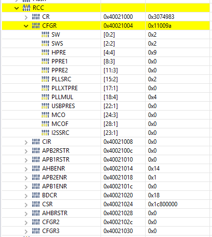

Read out and check/post the RCC registers' content just before that line.
2018-05-21 12:36 AM
Before __HAL_RCC_SYSCLK_CONFIG:
After __HAL_RCC_SYSCLK_CONFIG:
RCC_ClkInitStruct:

GHARBI.Nawres
,The RM clearly states that latency is based on HCLK:
Are you suggesting, that a serious error in RM (and, presumably, in other 'F3xx RMs) is to be fixed in CubeMX???
