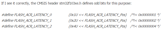

If I see it correctly, the CMSIS header stm32f103xe.h defines odd bits for this purpose:
#define FLASH_ACR_LATENCY_0 (0x1U << FLASH_ACR_LATENCY_Pos) /*!< 0x00000001 */
#define FLASH_ACR_LATENCY_1 (0x2U << FLASH_ACR_LATENCY_Pos) /*!< 0x00000002 */ #define FLASH_ACR_LATENCY_2 (0x4U << FLASH_ACR_LATENCY_Pos) /*!< 0x00000004 */In previous versions of the header file this wasn't the case, even thought the documentation of these bits appears a bit confusing:

Hi Peter,
Those code lines are used to define every bit's position in FLASH_ACR register (bit-field LATENCY).
To configure the wait states, you should use the definitions in ''stm32f1xx_hal_flash.h'' file.

thanks for your response! I'm still not 100% convinced. Also as bitfield, this definition
would represent bit number two, right? But the reference manual states that bit number one must be set for two wait states.

Hi Peter,
You should not confuse between ''FLASH_LATENCY_2'' and ''FLASH_ACR_LATENCY_2''.
FLASH_LATENCY_2: is what you should use to configure two latency cycles (2 wait states).
It's the second parameter needed by ''HAL_RCC_ClockConfig'' function.
FLASH_ACR_LATENCY_2: is the bit definition of bit N°2 in the ''FLASH_ACR '' register.
I hope this is clear now.
Regards,
Khouloud.

thanks again! Yes it's clear now. I was just too confused about the definitions in V3.5.0 of the header file which worked differently.
