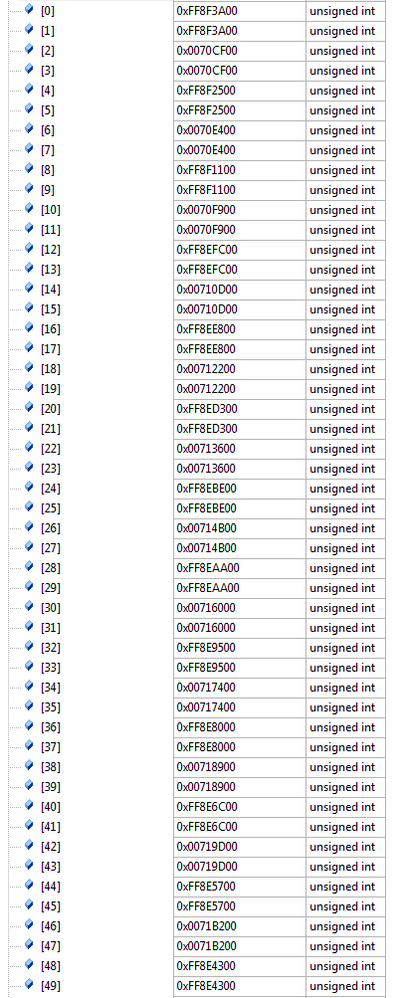

2017-01-06 1:29 AM
Ok i set the BUFFERSIZE to 100 and disabled the DMA after receceiving 100 Words.
My samplefrequency is 48kHz. The Signal is a 23,999 kHz Sinus Wave with 0,01 amplitude.The Master device sends only data on the left channel. Right channel is always zero.
With this setting i should get a positive word, a word filled with zero, negative word, a word filled with zero.
What i get can you see in the picture.
So the value looks good, only the zeroes are missing. Why is the data from the left channel always written twice ?
Niklas
2017-01-06 2:05 AM
Ok i found the problem. Wasn't a problem with the Code. I thought the Master send only data on left channel but he sended same data on the right channel. Now everything works correct.
