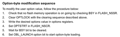

You can only read/write 4 bytes of the register. No problems there. Provided you unlock them first. Option bytes still need to be loaded after you write to the registers.
See "7.4.2 Option-byte programming" in the reference manual for the correct procedure to modify option bytes.
