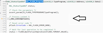

So what HAL error do you get? Have you stepped into the HAL sources and checked what exactly fails?

2026-01-02 4:55 AM - last edited on 2026-01-02 5:00 AM by Andrew Neil
Good point.
I am diving into the function FLASH_WaitForLastOperation. The error code is 160 and it returns HAL_ERROR.

I am going to check what is this 160 error code.
