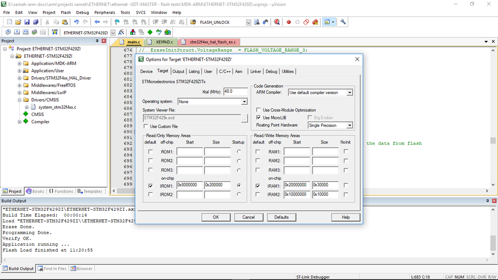

i dont read same value what i wrote to flash ????where is my mistake is it about about adress , i select the last sector to avoid interfering with prgm ,help needed thanks

how can i know the sectors not fulled by the prgm or ram data ? i dont want to damage my prgm ,,i mean where is my last adress used by prgm+data to know free sectors

tell me is this config correct for read and write between sector 0-------->23 stm32f429
