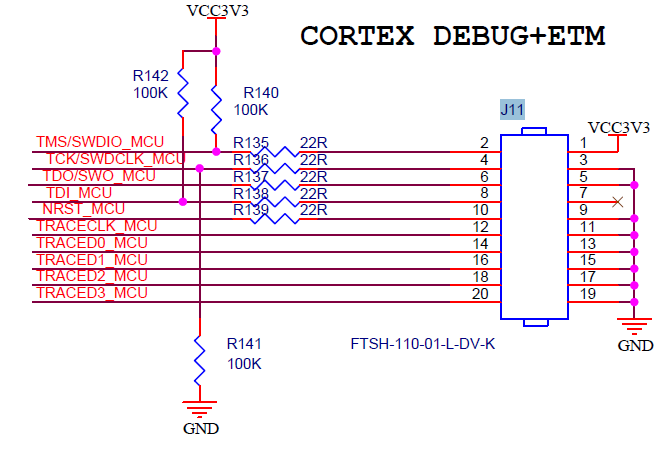

i am using stm32f7 and for debugging ulink pro, i have tried to enable ETM but not succedded. the connector i am using is, where traceD0-D3 are PE3-PE6.

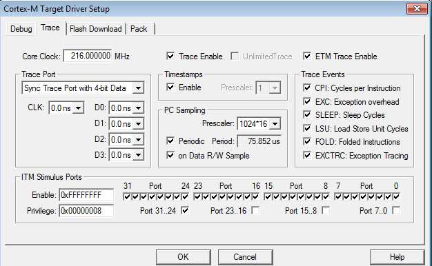

the debug settings i have also attached2018-04-20 5:15 AM
