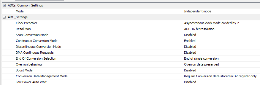

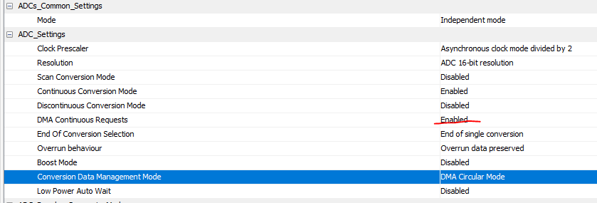

But when I change ADC1 config in cubemx to:
added a DMA1 stream0, with circular mode and changed the rows in my code to:
ALIGN_32BYTES (static uint16_t adcData[32] );
HAL_ADC_Start_DMA(&hadc1,(uint32_t*)adcData,32)
and no code in main()
Nothing works! If a check adc.dr register with the debugger it only takes one value at start-up and nothing more.
I've also fiddled with the Conversion Data Management mode as that parameter is a little unclear to me, circular mode is set in the DMA tab as well and the youtube clips I have seen is using older parts/version which doesn't have that setting.
