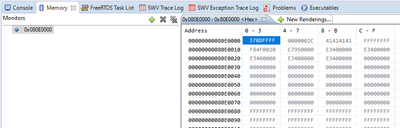

As can be seen from the image above, the first write was successful. On the PC side, the response comes correctly, but the next segment write cannot be started because the STM restarts itself.

2023-09-12 1:34 AM
Thanks for the advice, I checked the transmission chain and... I made a stupid mistake, I tried to write packets (via USB) that were larger than 64 bytes, which caused the internal logic to collapse. The FSM has interpreted the next data part not as a part of previous data transfer, but as a command to "reset" the STM...
