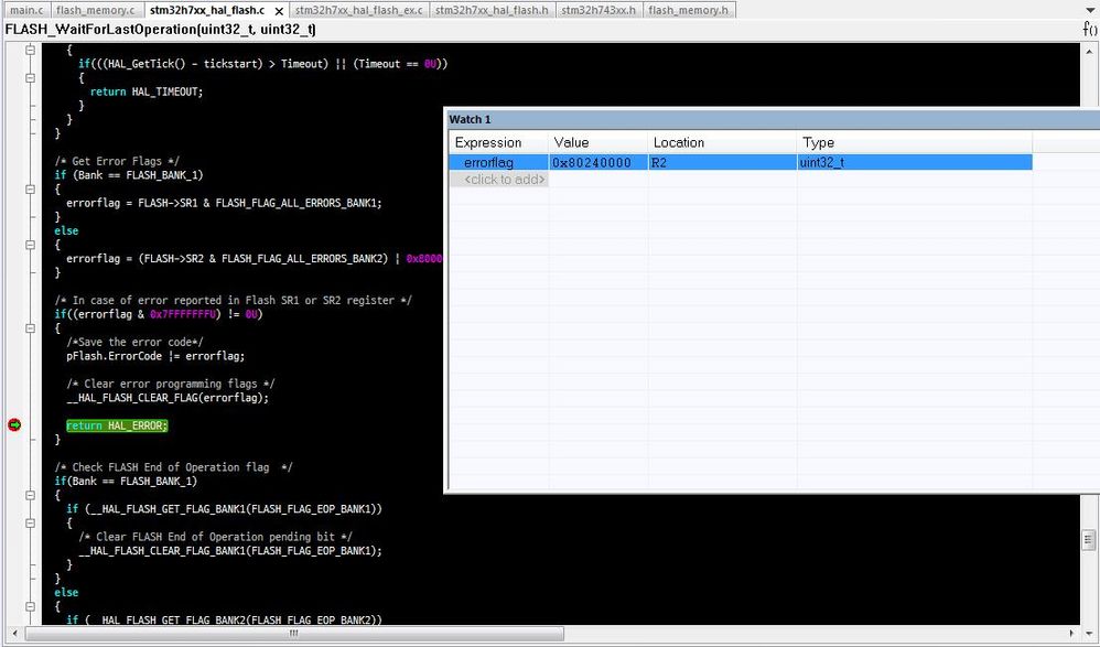

Sometime, It is return HAL_OK. So i can save some data in flash memory.
but Most of them fail to save...
The error code was return.
Error code is INCERR2: Bank 2 inconsistency error flag and PGSERR2: Bank 2 programming sequence error flag
what is woring?

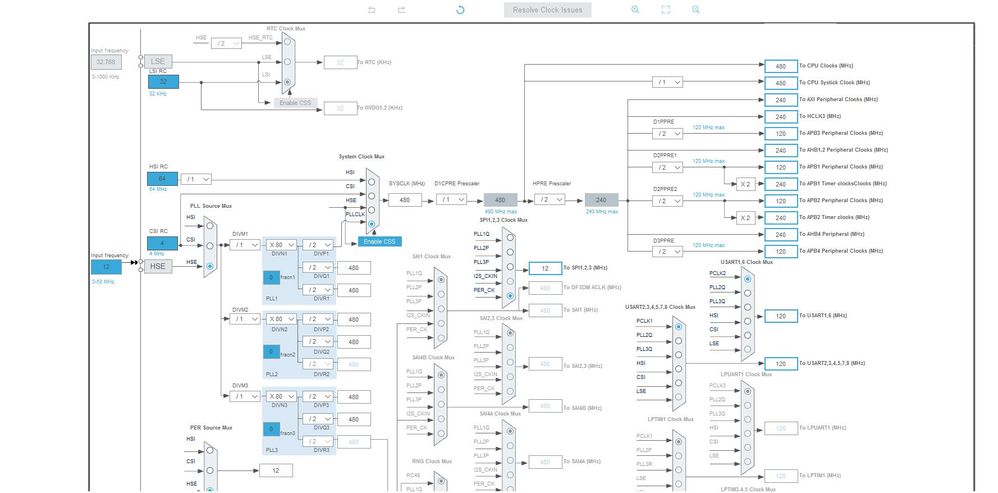

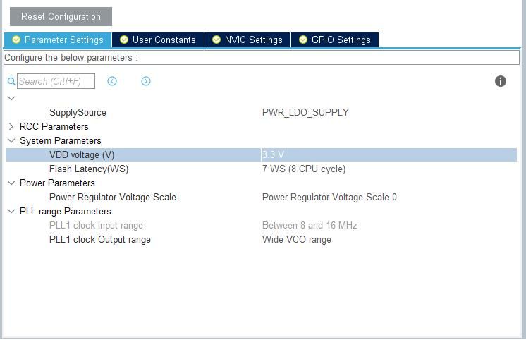

I will attach my code and configuration.
1) my data size : 112000B
2) My compiler is IAR (8.34)
3) My Cubemx Setting
