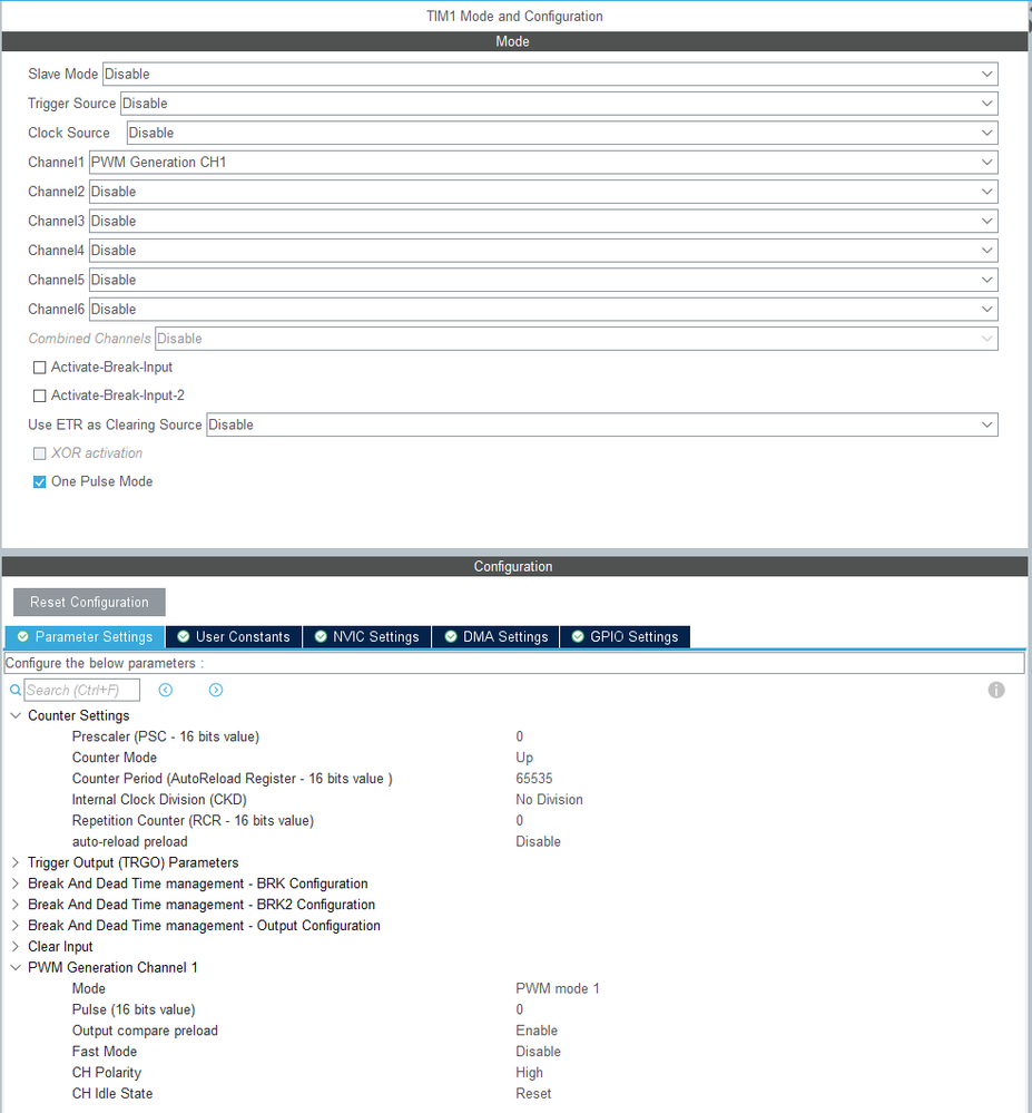

I need to generate PWM signals with adjustable number and frequency to drive a step motor. I expect the frequency ranges from 50Hz to 200KHz and the pulses count ranges from 1 to 2k.
I have tried 3 different ways including: using timer interrupt to count the pulse number; setting the PWM timer as master and using a slave timer in gated mode to count the pulse; using One Pulse Mode and the 16bit Repetition Counter (RCR). I used to think the last is the simplest and the most reliable cause all of the work is done by hardware. But the problem is the same. When the frequency reaches 200kHz the pulses count is inaccurate. More precisely, the count is always less than expected.

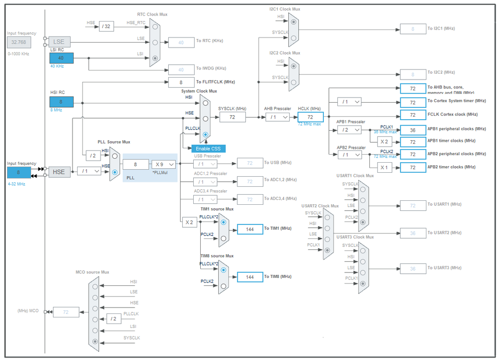

emm...I don't know why. But yes, the timer goes well without selecting a clock source in CubeMX. Maybe the default is Internal Clock. And I have just tested to set the Internal Clock. But the problem remains even when the frequency is just 20kHz.
Here is my clock configuration.
2022-11-13 6:39 AM
so, clk is on now. (not only by ...lucky preset or error)
How are you checking that? What is the difference to expected number of pulses?
Do you stop or restart the timer somehow?
Read out and check TIM registers content just before the counter gets enabled. That probably involves stepping through Cube code (which is open source so it's perfectly okay). Note, that RCR is effectively preloaded, i.e. it does not get effective until the next Update event.
If you do anything which is not supported directly by clicking in CubeMX, Cube may get into way more than help. Don't use Cube. Timers are not that hard to manage. You can play with them without writing code, in the debugger, to get the grips.

There are many things wrong. As already noted, several timer registers are preloaded. The timer clock is not 144 MHz - even the CubeMX shows it clearly and correctly.

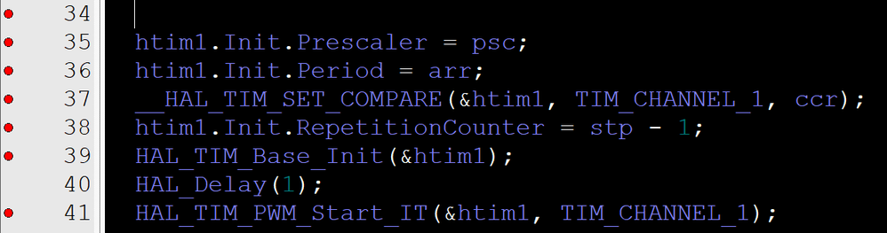

Thank you! I just checked the content of every register of TIM1 in debug mode. I found the cotent was accurate in debug mode. And the pulse count was also accurate up to 200kHz. The difference between debug mode and normal startup, I think, is the delay between breakpoints. So I just add a 1ms delay and the problem disappears.
Maybe it needs some time to reload the register...
