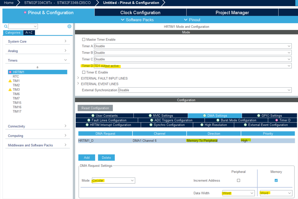

Hi all,
I wanted to make a post to shine some light on how to configure the HRTIM DMA on the STM32F3348-DISCO (and probably other ICs w/ HRTIM capabilities).
A few posts I've seen have boasted the same solution, but have convoluted the use of a single DMA request, Burst DMA requests and general Burst Mode configuration using the HRTIM. Here I'll try and walk through a step-by-step CubeMX and main.c configuration to step through a sine table with a circular DMA request to create a high frequency PWM sine wave using HRTIM1. Some basic knowledge of the ST Cube suite is assumed.
Hooking an oscilloscope up to PB14 (on STM32F3348-DISCO) you should see a PWM wave with a frequency of 100kHz changing duty cycle rapidly.
Hopefully this helps clarify some of the ambiguity of configuring the HRTIM. I'm excited to go further and sync some basic sampling with a few of the ADCs on the chip.

// STARTING WAVEFORM OUTPUT ON HRTIM D1 (PIN B14)
HAL_HRTIM_WaveformOutputStart(&hhrtim1, HRTIM_OUTPUT_TD1);
// START HRTIM COUNTER + CIRCULAR DMA TRANSFER TO HRTIM D COMP1
HAL_HRTIM_WaveformCountStart_DMA(&hhrtim1, HRTIM_TIMERID_TIMER_D);

2025-05-23 12:58 AM
Hi Claude_Lou,
I tried to configure HRTIM and implement like you but it'snot working.
