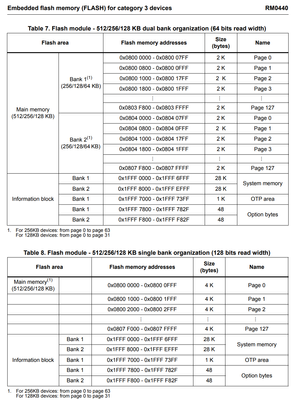

I checked the reference manual, and the flash is separated into 2K/4K on each page.
That means both 0x08008000 and 0x0800A000 addresses are at the page edge.
Why can't the application at 0x0800A000 work smoothly?
