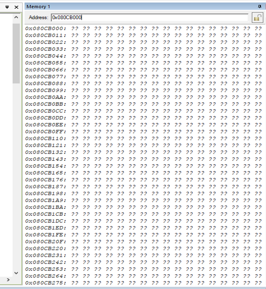

Hello! I am trying to save the data that I receive through bluetooth in the 1M flash memory of the Nucleo board(STM32WB55). But when I call HAL_FLASH_Unlock() the program goes to HardFault_Handler function and stands in the while(1). Besides that there are many addresses that have question marks"??" what decreases the available memory for me. The start address to save to is 0x0800A000. Any idea how to make my board save properly?

Dou you have a sreen shot of the ?? you get when reading the flash memory?
2020-06-29 5:07 AM
2020-06-29 5:09 AM
there is located the BLE stack:o
may be because of this
I didn't notice this

Yes as the BLE stack is protected againts any type of access as being located in a secure area.
All data above the SFSA pointeur is not accessible in clear.
