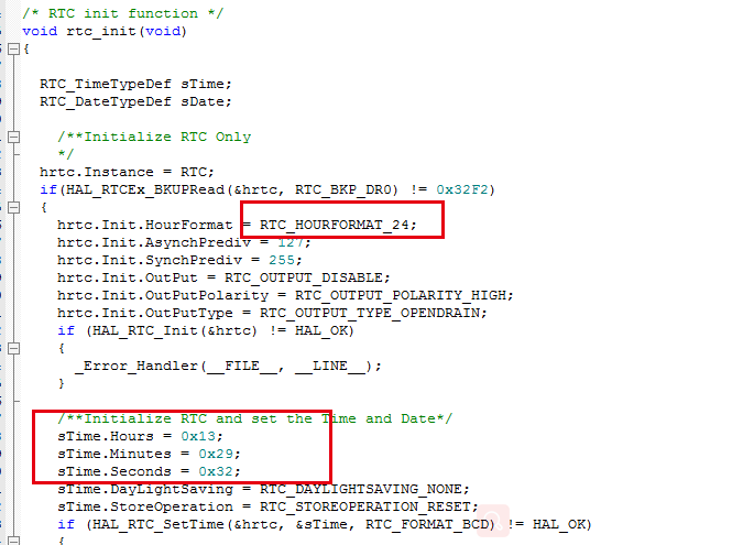

I find the RTC's HT's Value exceeds 24,when i use a stm32f401 mcu's RTC module to upload sensor data to geteway.I'm very confusing.
My project is made by stm32cubemx,and using the newest HAL library.

This happens if you set the RTC to 12-hour (AM/PM) mode (RTC_CR.FMT = 1) and set hour to 13 or higher.

I set the hour to 13 in fact,but don't set the RTC to 12-hour mode.I'll change the hour value to 10 and check again tomorrow.

Read out and check the RTC registers content.
