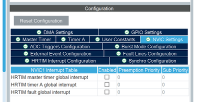

here i had called count start in interrupt mode and i enabled the interrupt for timer a but doesn't enters the calback is there is another callback function for this or i had do some changes . kindly help
2025-02-28 8:37 AM
The interrupt needs to be enabled in NVIC. Do you do that anywhere? In CubeMX there is a checkbox to enable this which will generate the necessary code.
2025-02-28 8:44 AM
I had enabled it also but it doesn't goes to call back function HRTIMA enabled
