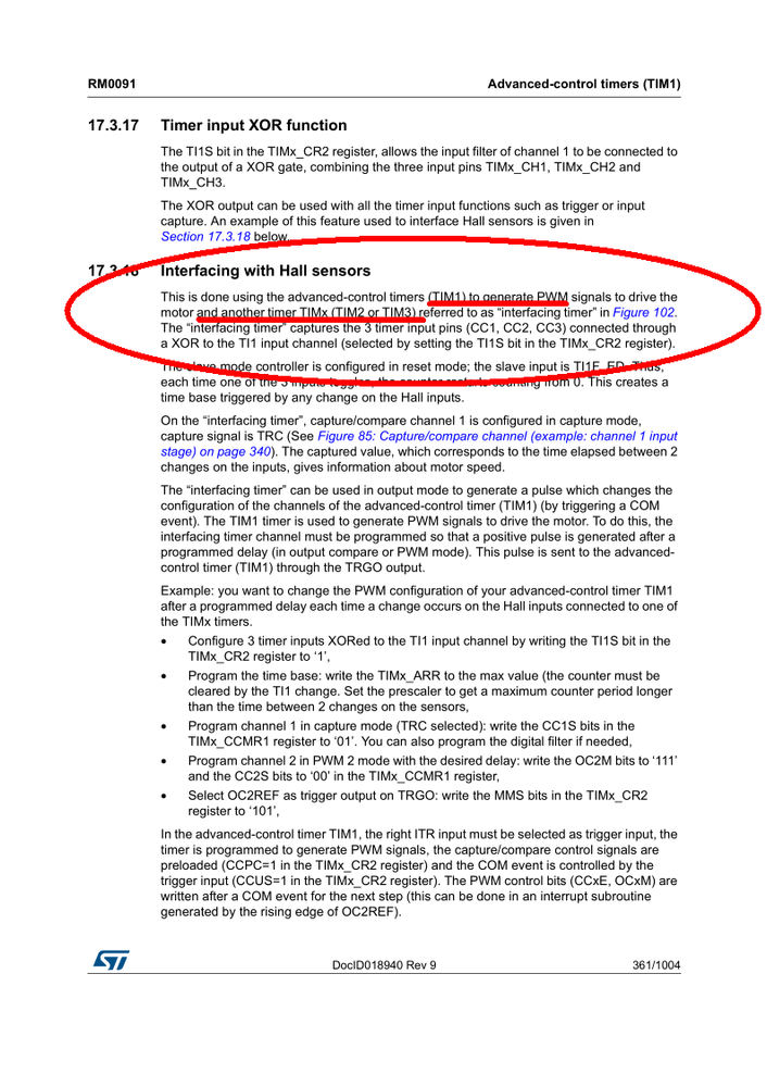

You first set CH1 to input capture (the "hall whatnot") and then in turn set it to output compare - output won't trigger on input pulses - contrary, the mcu output and the pulse generator are "figthing" now.
The whole Hall etc. subchapter in the timer chapter of RM is bizarre. It won't belong to the RM, rather, to an AN; and deserves a more thorought explanation with figures etc. No wonder it gets misunderstood.

well, i am not quiet getting. As far as i udnerstood, you set ch1 to input capture, and ch2 to output compare in PWM mode.

}So that function i used in a first posted code, does exactly what the RM says. why is it not triggering then? what am i missing?
