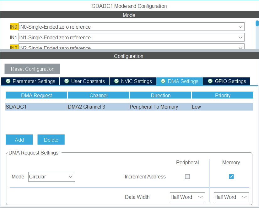

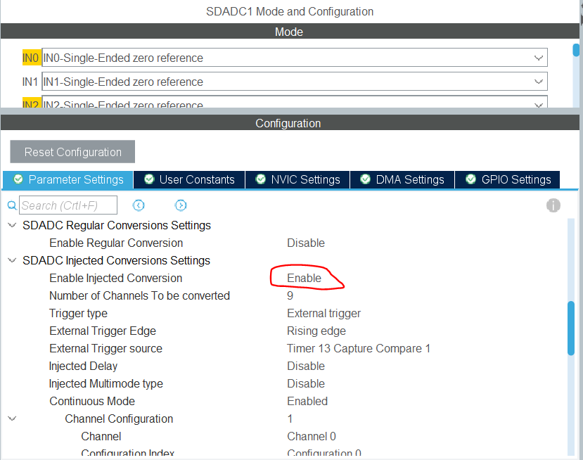

I'm doing SDADC and I think there is some issues with the DMA for SDADC in STM32CubeIDE 1.7.0.
First, I have enabled DMA for SDADC1, SDADC2, SDADC3 and I have selected InjectedConversion = ENABLE.

}The first thing that happens is that STM32F373VBTx calling this function
if(HAL_SDADC_InjectedStop_DMA(handler_sdadc1) != HAL_OK)
Error_Handler();Then next step is that it's calling this function
/* Stop current DMA transfer */
if(HAL_DMA_Abort(hsdadc->hdma) != HAL_OK)Then this if-statement runs
if(hdma->State != HAL_DMA_STATE_BUSY)
/* no transfer ongoing */
hdma->ErrorCode = HAL_DMA_ERROR_NO_XFER;
/* Process Unlocked */
__HAL_UNLOCK(hdma);
return HAL_ERROR;
}Because
hdma->State == HAL_DMA_STATE_READYThat means that the DMA wasn't enabled at the first time? Right?
This must be a bug, right?
And no...the SDADC with DMA does not work for me. Only with interrupt.
