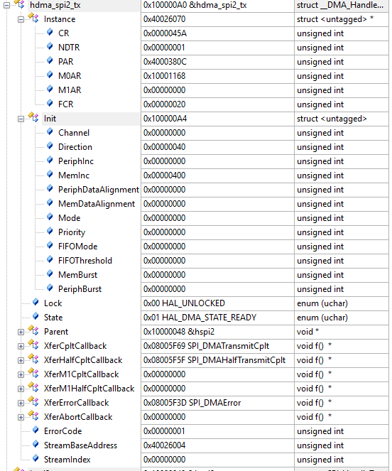

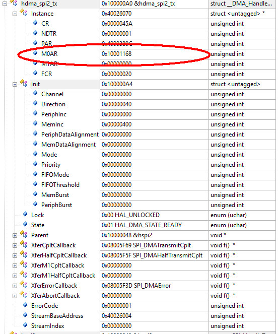

That address is in CCMRAM, and in 'F4, DMA does not have access to CCMRAM. Allocate the buffer in SRAM1..3 (i.e. at addresses 0x200xxxxx).

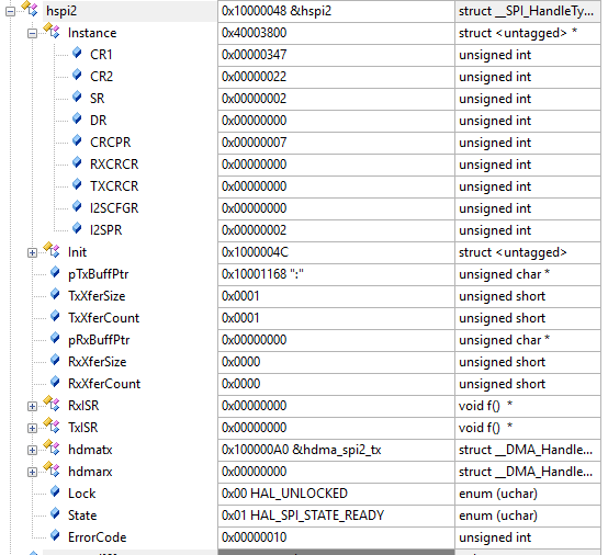

Read out and check/post SPI and relevant DMA registers content.
2021-08-08 5:58 AM
Hello Jan.
Thanks for looking into my issue.
Here is contents for SPI/DMA registers after trying to sent byte over SPI with DMA:
2021-08-08 7:22 AM
Jan, that really helps, thanks!

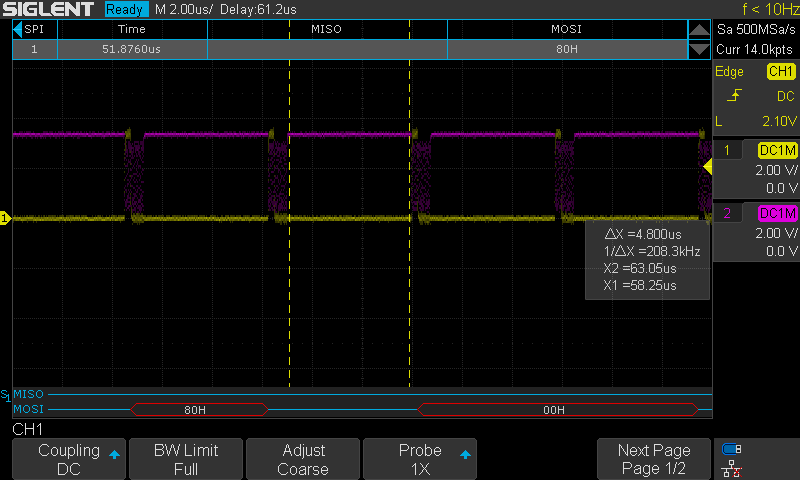

However, another question arises. Why there is so big gap between bytes transmission in DMA mode comparing with basic blocking mode when sending array of data?
Please see attached scope screenshots:
Without DMA:
With DMA:
Bulk data sending function is implemented this way:

2021-08-08 7:35 AM
Please ignore last post, reason of the delay is due to bytes were sent in separate TX_DMA requests in another function.
