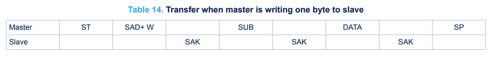

I am working with STM32nucleoL476RG on a code able to establish an I2C communication between the pressure sensor Ilps22qs and my board. I am using the Qvar functionality, so I followed this pseudocode as reported on Qvar documentation:

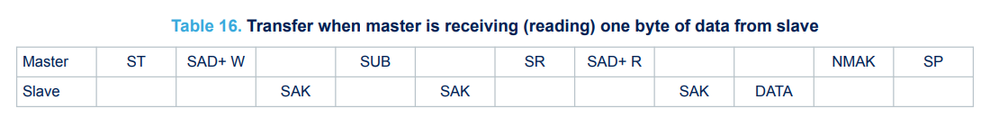

And then reading on register 2Ah, 29h, 28h to read the stored data:

Please check the results via an oscilloscope :
If nothings appears, please check the error flags set in the status register.
