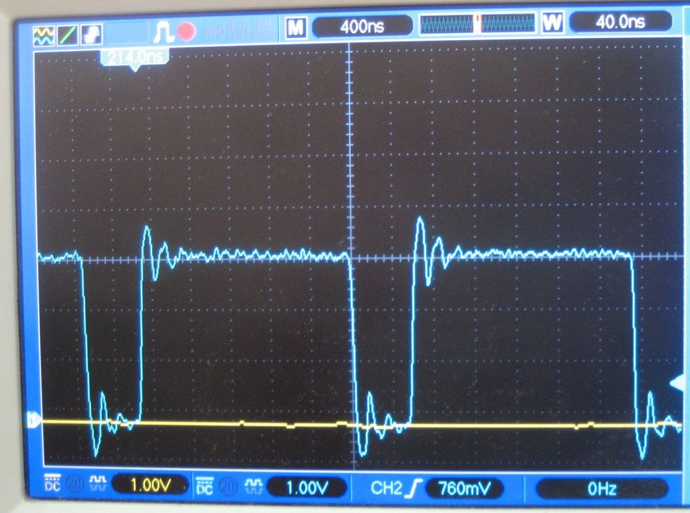

I'm using STM32F303ZE MCU's FMC(FSMC) to communicate with a special chip. FMC is cofigured in NOR/PSRAM mode, asynchronous, non multiplexed, timing mode D (see attached FMC configuration in CubeMX). FMC clock is equal to AHB MCU clock that is 70MHz. I see very long bus turnaround time between two consecutive writes into the same bank: 200ns instead of 14ns (1 HCLK clock). Bus turnaround time is set 1HCLK that is 14ns. Why real turnaround time is so big?
This oscillogram shows NE signal transitions during FMC write transactions. These write transactions are initiated by DMA controller in memory-to-memory mode. All other DMA channels are idle. Only SysTick interrupt (1ms periods) is enabled. CPU is not running (Sleep mode).

PS. If I configure FMC in mode 1, turnaround time becomes much shorter, showing that this shorter timing is achievable. Unfortunately I can't use Mode1 because external chip requires NE toggle between consecutive writes.

But the timing stayed the same.
I have also tried to send 32bit data to my 16bit FMC device:
DMA1_Channel2->CCR = (1<<14)|(1<<10)|(2<<8)|1;
but this didn't change timing either.
So looks like FMC is limiting turnaround time, but I don't understand why. Page 270 of reference manual says: "The programmed bus turnaround delay is
inserted between an asynchronous read (muxed or mode D) or write transaction and any other asynchronous /synchronous read or write to or from a static bank." (Description of field BUSTURN, reg. FMC_BTR). As I wrote, programmed turnaround time is 1HCLK, but the real turnaround time is much bigger.
