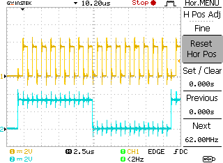

Chip type:F030C8T6Debugger:ST-LINK VIIWhen I use SPI in polling mode, i found a weird thing. I have never met this before when I were using F1xx series chips.The date size is set to 8-bit long and MSB first (SPIx_CR1=0x36C,SPIx_CR2=0x1700).Here is the main code.while(1){ SPI1->DR = 0XFF; while(SPI1->SR & SPI_SR_BSY); while(!(SPI1->SR & SPI_SR_RXNE)); temp = SPI1->DR;}This is the corresponding waveform.2016-01-08 8:28 AM
Is the sentence ''SPI1->DR = 0XFF;'' a kind of ''16-bit access of SPIx_DR''?
What's the structure define it as being? Because it will use that to determine it.Can anyone tell me how to read/write SPIx_DR in a 8-bit way like it is in F1xx series?*((uint8_t *)&SPI1->DR) = 0xFF; // simple casting

Thank you for your advise, it works!I also try to change the define of DR in the structure to uint8_t, it has the same effect. :DBut I am still confused why ?SPI1->DR = 0XFF;? and ''*((uint8_t *)&SPI1->DR) = 0XFF ;'' show up in the same assembly statement.Sentence:SPI1->DR = 0XFF;2016-01-08 6:08 PM
STR (Word) vs STRB (Byte)
