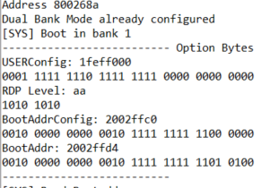

You can view some logs in attached files:
I can do the swap directly with STMCubeprogrammer but I cannot do it with code so i suppose that it's an error of configuration or code.
