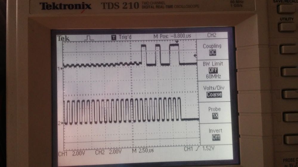

Using your scope, what do you see at the MISO line ?
The SPI interface has several clock polarity and trigger edge options, check with the datasheet of your slave device.
I suspect the slave does not really answer.
2017-11-02 2:57 AM
Clock vs MISO line. The last 8 bit should be the answer, seems correct.

In any case, what I concluded is that I definitely read 0's from the Rx buffer since the read instruction overwrites the variable spiRecived initialized to be 0xFE, which on the attached code might be zero now.
I also concluded that I do receive answer from the slave, because I checked the memory cells I am reading from, and the data on the scope corresponds to it. So the data is there on the MISO pins but somehow I copy 0's from the Rx buffer.
