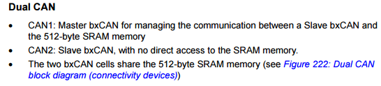

In STM32 MCUs CAN1 and CAN2 share some resources (mainly SRAM memory) and these common resources are managed by CAN1. This is in fact the explanation why CAN1 is called Master in ST doucmentation and CAN2 is called Slave. This naming can be a bit misleading, because both these CAN interfaces are fully Multi-Master (not Master-Slave), like it is defined by CAN architecture. Anyway in such situation when you use CAN2 and CAN1 is not used, it may happen, that CAN2 has no access to these resources. Based on
STM32F107 reference manual:
To overcome this limitation it should be enought to enable the clock for CAN1. Could you please check this solution and let me know if this solves the problem?
