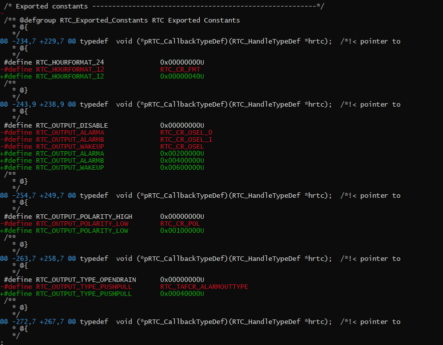

Hi, I have solved this, replacing the following files by old version of the hal API from other project:
Drivers/STM32F4xx_HAL_Driver/Inc/stm32f4xx_hal_rtc.h
Drivers/STM32F4xx_HAL_Driver/Inc/stm32f4xx_hal_rtc_ex.h
Drivers/STM32F4xx_HAL_Driver/Src/stm32f4xx_hal_rtc.c
Drivers/STM32F4xx_HAL_Driver/Src/stm32f4xx_hal_rtc_ex.c
I only replacing, but we can see in git diff the differences
If you look at the definitions of the symbols you've replacing, you'd see the same values. Thus, this is not the reason of the "fix" which is quite likely concidental.
I believe most of the problems in this thread are caused by uninitialized local structs used to set up the RTC or the time there.
It wasn't just what's in the diff that changed, but all .c code, and for me it resolved.
