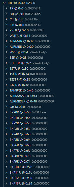

OMira.1
Associate
Hi Albert,
I'm facing the same problem with an STM32l476 MCU.
We've managed to break the execution of the software without resetting the board and got the RTC register.
Below, the values. Did you solve this problem or find any0693W000004IoOFQA0.png workaround?
Regards,
Oliver
