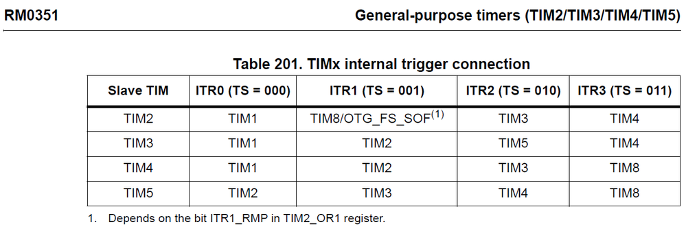

I am working on the NUCLEO-L476RG board. I am trying to use two pairs of counters in master/ slave mode. In the first chain TIM2 is the master and TIM4 is the slave so in SMCR of TIM4 ITR1 is selected and this works as expected. In the second chain TIM5 is the master and TIM3 is the slave so in SMCR of TIM3 ITR2 is selected and this does not work. Using the debugger I can see that TIM5 is counting but TIM3 is not. Also I have configured GPIO so that I can see action on oscilloscope.
I have tried setting SMCR of TIM3 to ITR0 (TIM1 master) and that works
I have tried setting SMCR of TIM3 to ITR1 (TIM2 master) and that works
I have tried setting SMCR of TIM3 to ITR3 (TIM4 master) and that works
Why does TIM3 not count when SMCR is set to ITR2 and TIM5 is master?
Reference Table 201 in RM0351
In all instances the master TIM has MMS in CR2 set to 2, UPDATE.

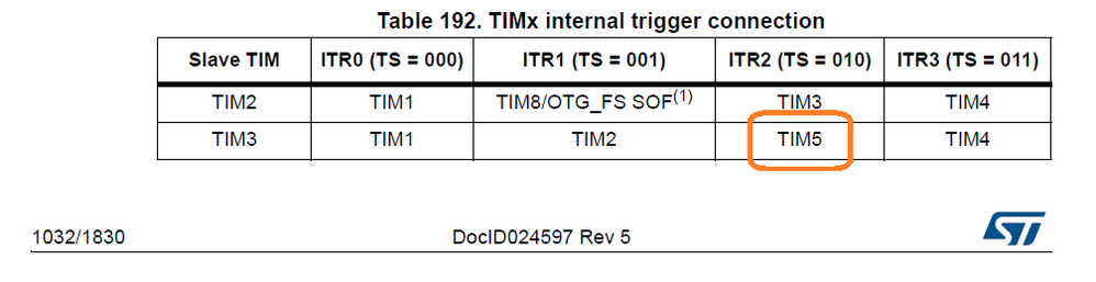

It's TIM15 not TIM5. Try.
@Imen DAHMEN can you please put it up to the list of things to fix in the documentation. Thanks.
2018-10-28 5:26 PM
Yes, TIM15 seems to be what it is, stupid docs..

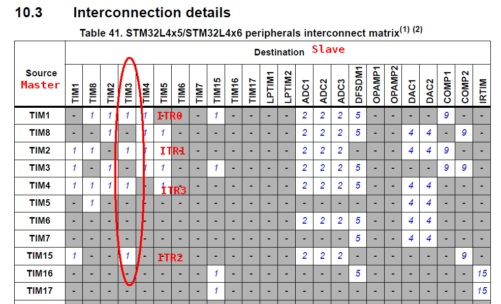

If you wonder how did I find out: remember how I always brag about the Interconnections chapter? Turns out in this case it was the one which contained the correct information...

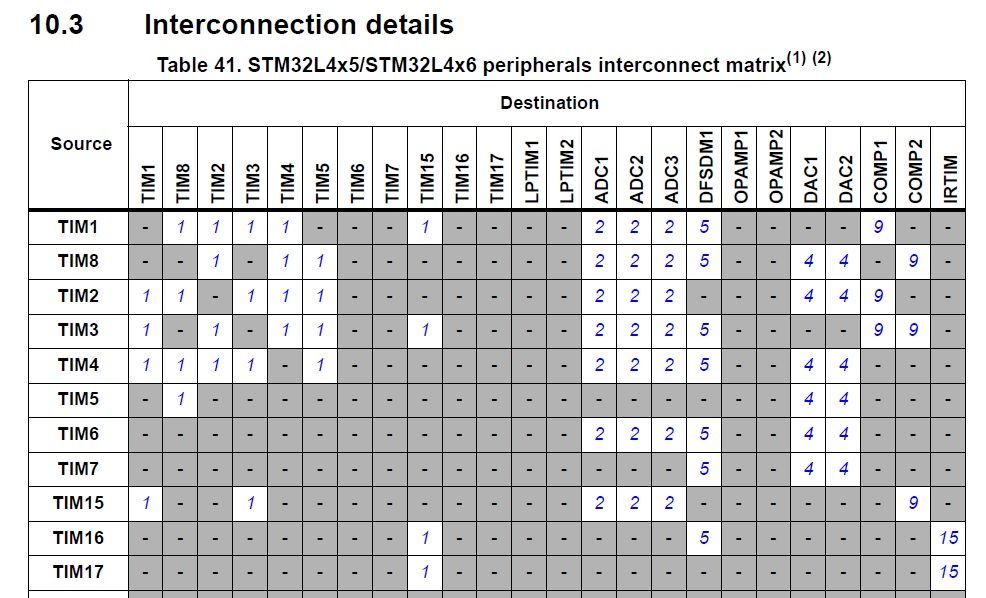

Fair enough, but how does it associate with TIM3 (i see the TIM5 and TIM15 columns marked), got 5 boxes, and 4 ITR, or is that broken too?
2018-10-28 5:46 PM
I'd guess there is a mux option for TIM5 vs TIM15, but the chapter that should explain that seems a bit vacant of such detail. Just points at other tables, which in this case has an useable option documented, doesn't say TIM5 or TIM15
2018-10-29 1:20 AM
You have to look at the column, as it's TIM3's perspective as Slave, selected in TIM3_SMCR.TS
2018-10-29 1:40 AM
Ok, I was playing across not down. Wouldn't this table be more useful with boxes saying ITRx?
Like playing battleships via sudoku.

In the timer section of the Reference Manual this is the information presented.
I have been looking briefly through some of the Reference Manuals for STM32F family members and there is no Interconnection details section and I have always relied on the corresponding table to that inserted above. The other families present the TIM3-TIM5 connection and so the question is why make this change for the STM32L4xx series? And why not correct the information presented in the above table, this is after all revision 6 of RM0351. The same error is present in RM0392. It might be useful to have a bit in TIM3 OR1 or OR2 that enabled TIM3-TIM5 connection, just a thought!
