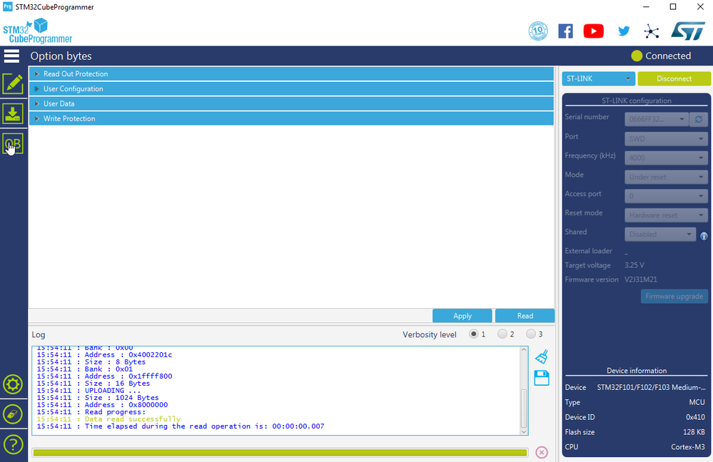

2020-04-15 7:59 AM
2020-04-15 8:00 AM
You can modify the BOOT1 state by using the option bytes.
then you can modify BOOT0 and BOOT1 according to your needs.
Best Regards,
Mohamed Aymen.
