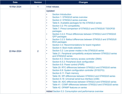

Hi Wek, please note that revision two has been published Friday evening, embedding comparison of the consumption and also multiple images about the pinout similarities and differences.
Thanks for the valuable feedback and proposals!
Link: Migrating from STM32L0 to STM32U0 MCUs - Application note

Thank you Very much @Viktor POHORELY and also to @waclawek.jan & @Uwe Bonnes to Close the topic and new release of the application note in a record timing of 3 days !
