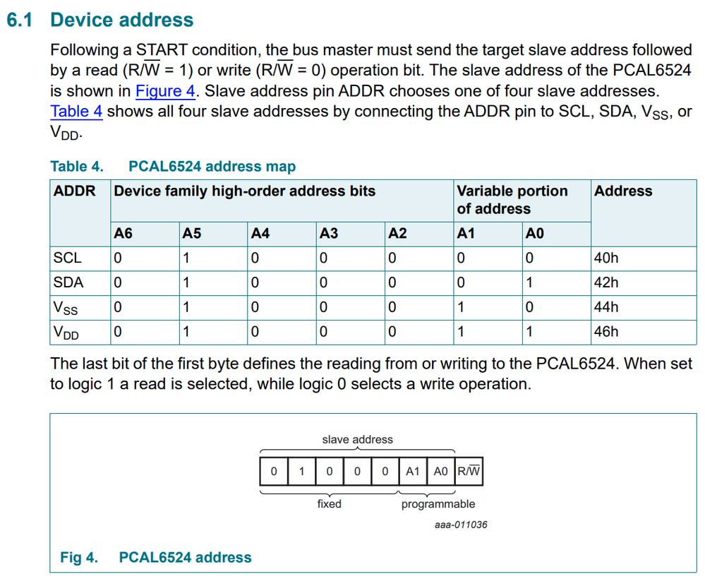

why we need shift device address? whats its purpose?
tx_buff = (dev->addr << 1);
if (HAL_I2C_Mem_Write(dev->i2c, tx_buff, addr, 1, &value, 1, 10000) == HAL_OK)
return false;
2021-11-26 10:59 PM
I2C slave addresses are 7-bit, but on the wire those are the upper 7-bits within the byte, the least significant bit of the byte indicates whether it is a read or write interaction.
2021-11-26 11:05 PM
Then I am using the 46h address then for write purpose i have to use 46<<1 am i right
2021-11-26 11:09 PM
The 0x48 value looks to have already been shifted. If you are shifting use address 0x24 instead.
Different chip vendors and software drivers manage this differently, so you should establish the bit mapping described in the datasheet vs the software side expectations. It requires some attention to the details.
2021-11-26 11:12 PM
I can't understand what you told can you please exaplained me ,i am confused in this address.
