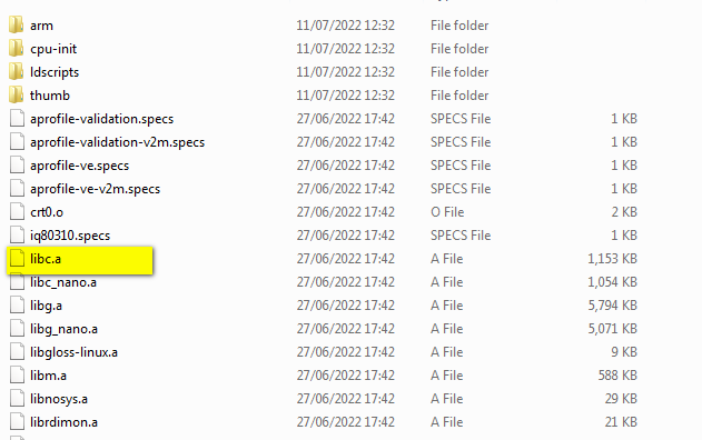

and under lib I find newlib.h which is full of interesting #defines like
#define _RETARGETABLE_LOCKING 1
but all this stuff has already been compiled, and I have no sources (except that one from year 1990 which looks pretty similar, right down to using same mutex function call names, 32 years later!).
Also stdio.h is in there.
I see no way to alter any of the symbols already in the libs.
Note I am not using newlib-nano, due to lack of support for uint64 and some thread-safety issues. I am using standard C.
Currently I am investigating a linker (LD) option for suppressing the duplicate symbol warning on specified symbols (have not yet found one) but I have no way of knowing whether I will end up getting my version or the library version. Probably the latter, since it is linked second?

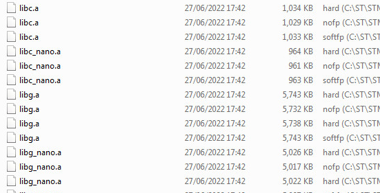

This could be a big job. And that assumes I find the right .a file. I did a string dump of that libc.a and it contains all the printf versions and a load of other stuff. It also contains the mutex functions seen while stepping through printf and malloc etc
__retarget_lock_init __retarget_lock_init_recursive __retarget_lock_close __retarget_lock_close_recursive __retarget_lock_acquire __retarget_lock_acquire_recursive __retarget_lock_try_acquire __retarget_lock_try_acquire_recursive __retarget_lock_release __retarget_lock_release_recursive __lock___arc4random_mutex __lock___dd_hash_mutex __lock___tz_mutex __lock___env_recursive_mutex __lock___malloc_recursive_mutex __lock___at_quick_exit_mutex __lock___atexit_recursive_mutex __lock___sfp_recursive_mutex __lock___sinit_recursive_mutex
