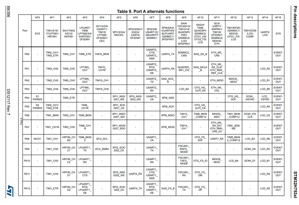

2021-06-26 8:42 PM
They are in the datasheet, page 88+.
https://www.st.com/resource/en/datasheet/stm32h743bi.pdf
Your question says H743 but DS12117 is for H753. Perhaps a typo.

2021-06-26 8:56 PM
Thank you. Could not make it thru table 8...
