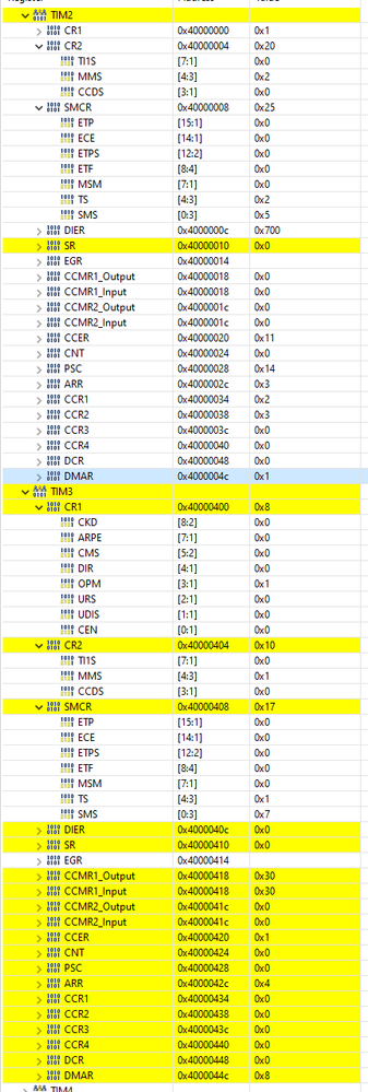

This is the initial configuration just before dataTim's enable..
If the compare's are set to 2 and 3 how can they generate DMA request at start?
My mistake might be prescaler is being updated after first cycle.. It looks like TIM2 runs at full speed for first cycle, but recovers after the second..
