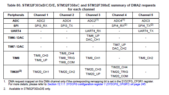

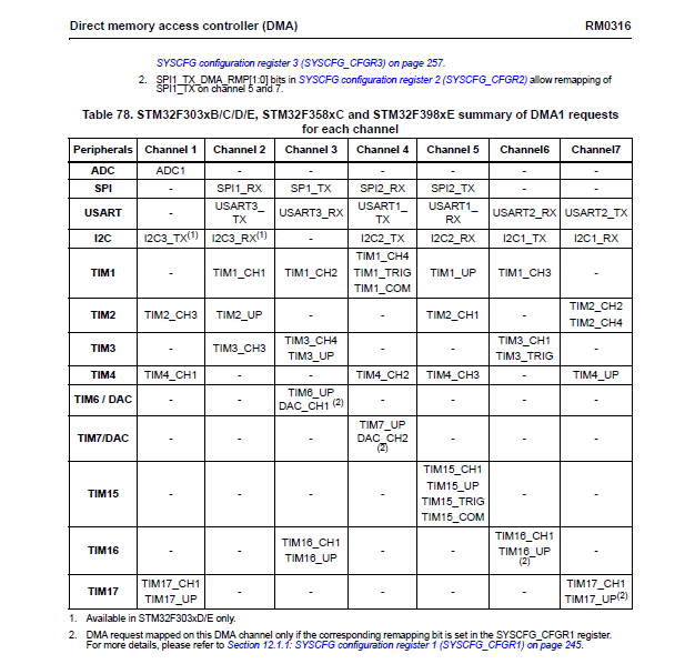

2017-11-17 12:17 PM
I appear to have solved the issue. Looking further in the datasheet I realized that ADC2 was not connected to DMA1 channel 1
The correct DMA connection to ADC2 is DMA2 Channel 1:

2017-11-17 12:17 PM
