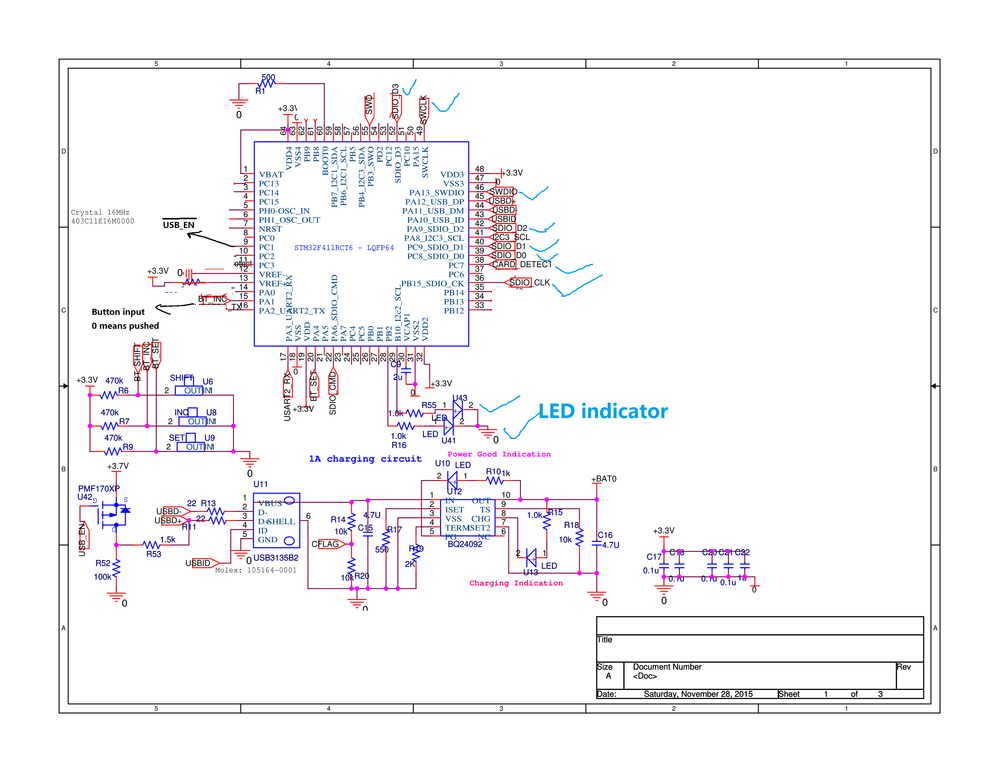

2017-01-23 5:13 PM
Clive,
PC7 is used for detection.
Or maybe you can just leave it always enabled
.I have two LED,
PB1 is for green
, PB2 is for red. Turn on green if everything is OK, otherwise turn on red.I used USB(CDC) for debug info. If you could build simple msg output interface,such as keep sending data to usb to tell the progress, that will be great. Please set PC1 as gpio_output, and set it to 0 to enable usb. Or just light up LED to indicate the status without usb msg.
Button: I use
PA1 as inpu
t. Once button is pushed(io reading turns to LOW), the program starts writing/reading sd card and send msg to usb. If it not convenient, just ignore it.As the pin configration. F405 is different from F411 for 3pins, two grounds and one VCap. I do check the difference.
when I use difference chip, the connection of the board was slightly modified such as jump wire etc.
Please use the schematic below to generate a testing code. If it go through, which means hardware is not the problem.
Appreciate your assistance.
2017-01-23 5:33 PM
I'm not an advocate for HAL/CubeMX
What Pin are you using for the Card Detect pin of the socket?
If you have details of pins, USARTs and LEDs, I could build a demo using the SPL
Are you sure it is not something with the pins of the 411 vs 405? Did any of the power, VCAP, or strapping get changed. Review a F411 DISCO schematic vs the F407 one.
2017-01-25 12:29 PM
Clive,
Do you have anything I can test on the board? Appreciate for your continuous support.
2017-01-25 3:10 PM
Not got to it yet, need to separate things out and deal with the lack of USART output for diagnostic. I guess we could use SWV
On headless stuff I'd write logs to the SD card, but that obviously has to work for that to be viable, so a bit of a catch-22 in this situation.
The LED appears to be on PB10 not PB1
SDIO_D0 PC8
SDIO_D1 PC9
SDIO_D2 PA9
SDIO_D3 PC11
SDIO_CLK PB15
SDIO_CMD PA6
SDIO_DETECT PC7
2017-01-25 3:39 PM
swv is good enough.
It is PB2 and PB10. Sorry PB1 is used in another board.
If I can see the info via SWV, no led is fine
I double checked the pin for sdio, they are correct.
Thanks

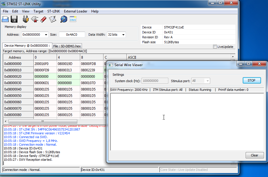

2017-01-25 10:34 PM
Here is a test build, should output to SWV a 100 MHz on F411 and 168 MHz on F407
https://drive.google.com/open?id=0B7OY5pub_GfIelExRk5TcjBRZmc
2017-01-26 11:19 AM
Clive,
Do you mind send me the source code?
I tested the hex file you sent to me. I didn\t see msg in the swv window.
I tried 100MHz or 96MHz. Still didn't see anything.
The LED light: at beginning both of them light up. after pretty long time about 1min, the left led(green) is on, and the right is off. Then wait for another 1 min maybe, leds switch. I checked the uSD card, there is no file on it.
By the way I am using internal 16MHz clock as the clock source, then PLL to 96MHz. No extern clock source is available on the board.
