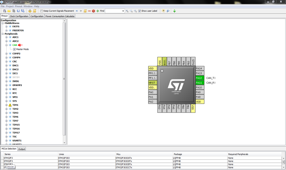

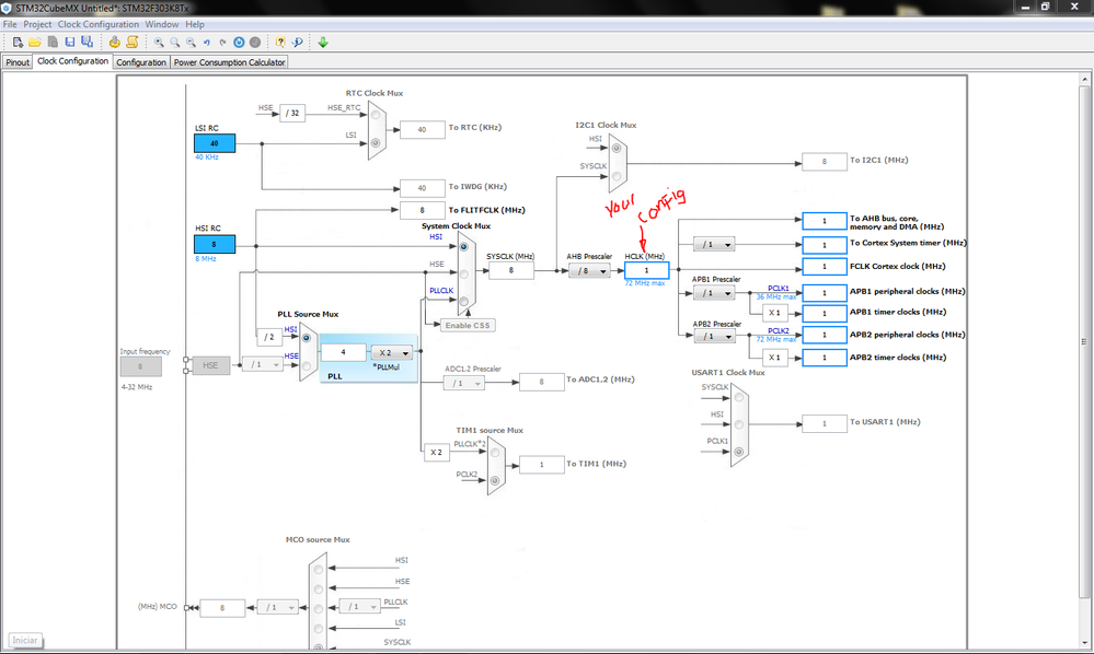

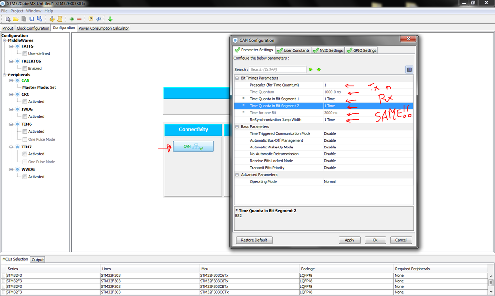

Other common issues are from time configurations, I suggest to you to use the CubeMX to inicialice the CAN port, in the clock tab make the configurations of the board clocks and crystals, and in Configuration tab set all the parameters well:
Some really really important is in the last image, you must to take on count that both Tx and Rx module must have the SAME configuration!, if one of them don't have the same configuration, the modules will never communicate well.
