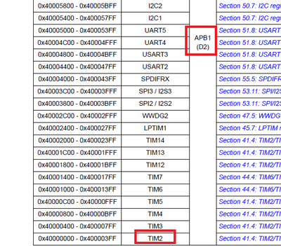

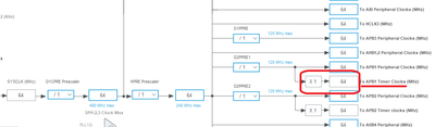

TIM2 kernel clock is generated from APB1:
From the reference manual:
In CubeMx:
That clock is devided with the timer prescaler
In CubeMx:
2025-05-30 1:22 AM
Divide it down and have in Toggle mode one of the TIMx_CHx pins associated with it.and measure it on a scope?
The clock tree should be usable to determine the base frequency.
