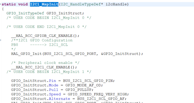

Hi every one,
I found the source of the problem so I want to share it !
One thing I didn't mentioned is I use NFC7 library for my project because we also embbed an ST25DV64KC.
Obviously it does not use SPI bus but I2C. We used an example code from nucleo as base for the use of the ST25DV. In this example code the function BSP_I2C1_Init initializes I2C bus by calling I2C1_MspInit and starts by a call to HAL_GPIO_Init(BUS_I2C1_SCL_GPIO_PORT, &GPIO_InitStruct);
GPIO_InitStruct is not initialized so this line overwrites any configuration previously done on GPIOB port which is where my SPI clock was (an also others signals).
As the init of the library is called after the whole peripherals init, all peripherals related to GPIOB had wrong configuration.
Next time we will be more careful with the use of example code and we probably will start from scratch to make sure we have full control on our code !
That's it, thanks for your help and have a nice day.
